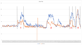

  • With help from a ConnectIQ app and some members of this forum I was able to plot OHR and Strap-HR side by side, during about 35 minutes of just being around the house on a Saturday. The results aren't good, although I've seen much worse.
    Until (1), I was just sitting at my computer and hardly moving. OHR behaves quite well.
    (1) I get up and do very light activities around the house - putting away some wash in the closet, etc. OHR jumps high, and also takes a long time to reach real resting HR once I'm sitting back down.
    The glitch in between (1) and (2) on HRM-Run was when the watch suddenly lost connection to the strap, so that can be disregarded.
    (2) The same kind of house chores, although I'm not quite sure exactly when they ended so I didn't add the black lines. OHR is totally off anyway, and totally unsure why it jumped a 2nd time.
    (3) walked downstairs, about 75 stairs. OHR jumps too high, and also doesn't cool down as I just stood completely still leaning on a wall at the entrance level.
    (4) Walked back upstairs. OHR picked this one up (this time) very well, albeit with a constant 20 second delay. Notice how the OHR reported something quite similar upon walking downstairs to walking up them.
    Like I said, I've seen much worse behavior than this in every day life (although I find this is already bad) and I will try to wear the strap on a full day and see what results I get. As I said, sometimes walking up these stairs results in zero change in HR (can be as low as 55).
