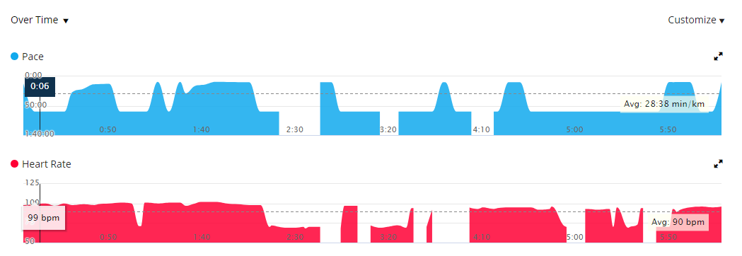

Hi. Recently in the gym I have been experiencing drop outs with my foot POD and HRM-run while on the treadmill. Strange thing is it only drops out when I am on the actual treadmill. I can walk around the gym with no issues. I have never experience this previously with the same 935 and foot POD/HRM-run. Any thoughts or suggestions would be appreciated. Cheers (I have attached a pic of the drop outs) ciq.forums.garmin.com/.../1430924.png
  • The obvious suspect would be electrical interference from the treadmill.

  • Ye, guessing it is interference but I have never experienced this before as I have been going to the same gym for years, same treadmills, same POD, etc etc. Just really interested in what it could be or if there is something I have done in settings which caused it.
    Its pretty trivial but I dont like to run on treadmill with watch on, gets really sweaty around the buttons, so I put it down on the treadmill. But with this interference I have to rely the 935s pace reading.

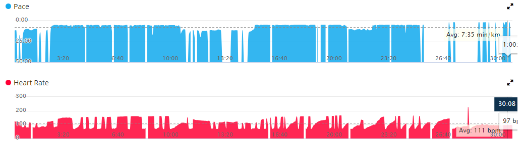

    Went to gym again this AM and same thing. I have attached image of the file from today and .fit file (zipped).ciq.forums.garmin.com/.../1431198.png

    Will update to every second now. I have attached my spinning session on a watt bike I did before the run. Bike is approximately 20m from the treadmill. I placed the watch next to me on the spin bike so HR readings just from HRM-tri with no issues (can see only two 'drops').
  • Thank you. That all is very useful to know. I have never tried turning off OHR so will give that a go for sure. At least it may then potentially resolve the interference with HRM-tri.
    Ye, the spinning (watt) bike is positioned away from the treadmills on the gym floor. When my foot pod is on my running shoes (beside the bike), it is connected to 935 with no issues, hence the 80% at start. The 3 drops from HRM-tri are not noticeable while spinning. Once I leave the bike and head to treadmill, the interference starts.
