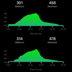

After upgrading the firmware to v12.0 for my Garmin 745 and not having the elevation issue fixed, I downgraded my watch to firmware v10.40.  I see many posts asking how to do this, so I thought I would post the information here for the benefit of others.

Note, you need a PC to do this work.  I could not access my Garmin on my Mac.  You will loose all of your settings, but I thought it was a small price to pay to get the proper elevation readings during my runs.
