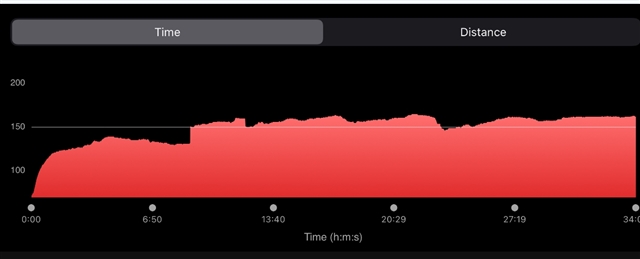

    It's pretty hard to buy into, that at about 8-10 minutes into a run, with the watch securely tight on my wrist, I switched to a velcro closure strap that has infinite adjustment, suddenly my HR takes an immediate vertical jump and stays there. It's not a spike, it's a leap which doesn't happen using the FR245.
    4 mile outdoor run 1/5/2026
    "However, if you have other examples you can provide that show a distinct difference throughout the activity or a more sudden spike/drop in HR data, we'd be glad to examine those and provide assistance"
    So for my use, that sudden vertical jump to new levels is the problem, which I perceive to be filtering. I do not expect the Optical HR to be as good as a chest strap for instantaneous values but I am expecting it to be at least as good as my FR245. I did a chest strap vs optical HR comparisons (same activities) for the FR245 (long ago) and the comparisons were really pretty darned good.
