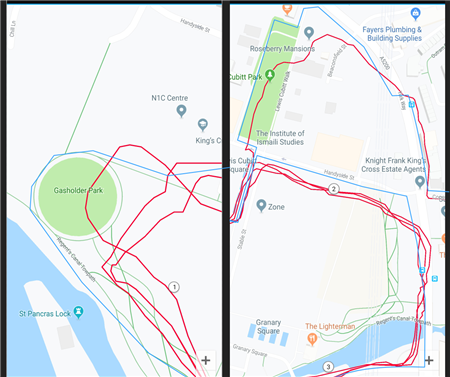

    I got the replacement yesterday, I've walked several times with it (around 10k), tried GPS soaking at home and at work, seems just a bad as before, rarely keeps me on the right side of the street and zig zags all over the place. I'll take it out fro a run tonight but so far I'm very disappointed.
    Post run, here are the results. My actual route is in blue.

    The run was a little faster than usual. However I can't really tell if I'm running a bit further in a faster time  due to the watch cutting so many corners, about the same, or actually a bit less due to it going wide in certain sections.

    Ah, the image above is from the run.

    not so nice tracking result after the exchange...
    explanation would be the surroundings like:
    metal constructed buildings, power lines above or below ground
    there was once a post about speed anomalies on an industrial track along a canal or river (memory is playing with me)
