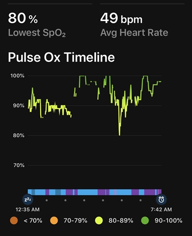

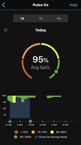

  • I suspect it is a combination of hardware and software. To be specific, I suspect there are multiple versions of hardware in use and the software is not compatible with all. I say this as my unit has not had all of the issues that are being reported. My pulse ox works (turned to on all the time), respiration works, battery drain issues resolved with the 3.4 update.
    I turned my pulse ox to always on Wednesday night. Last charge was Tuesday night before bed. Used Amazon app to play music for about two hours since the last charge. Watch face is Titanium with the display set to altimeter (I assume this uses more power that the step distance field). Battery is currently showing 18% with 67 hours of use.
