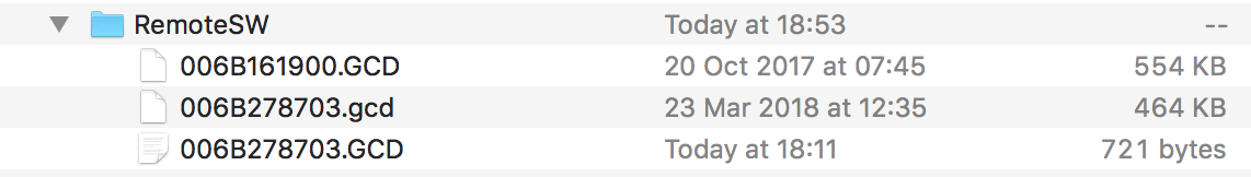

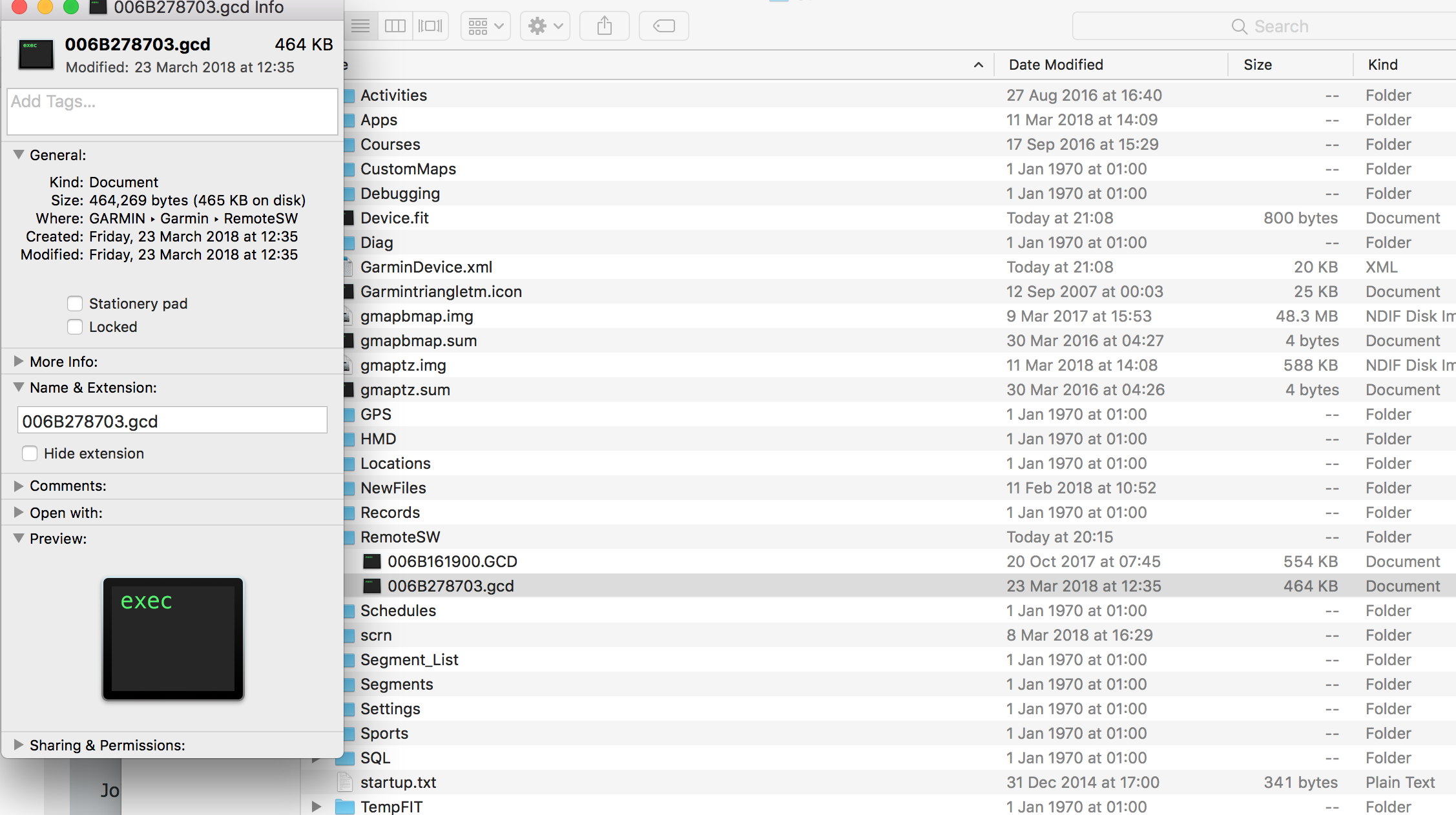

  • I am struggling to update my Vector 3S as well. Tried everything that has been suggested and made sure that the Edge 520 is fully ejected. I have re-paired my Vector 3S with the 520 Head Unit but still I cannot force the software update. I have attached a copy of the RemoteSW folder from the Edge 520, to see if there is anything I need to delete. I did notice a file from 8 Feb which I think was SW 3.0. I removed that but then re-added it as I did not know if I still needed that or not.ciq.forums.garmin.com/.../1328001.png

    Something does not look right. You appear to have 2 files of the same name and file extension. Delete the one that is 721 bytes
  • You have two .gcd files with the same name in your folder. One of them is an older one probably from the last update.
    I had the same! Take a copy of them for backup somewhere on your PC, then remove them both from that folder on your edge.
    Then just add the new one you have downloaded today, making sure you have unzipped it.
    It should work fine then.
