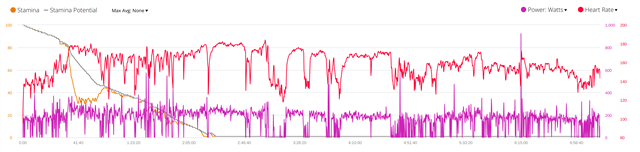

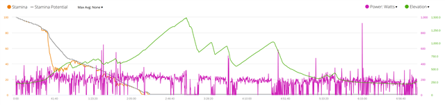

Stamina is completely useless.
Introduction: I have the Fr955 and Edge 840. I wear the watches constantly, even when I sleep. I only take them off for charging. So Garmin knows everything about me that it needs to know.
How is it possible that after stamina is depleted, I can still ride for another hour without changing my average power? And at the end of the workout, I still feel energetic, without any sense of depletion or exhaustion?

  • There were no maximum efforts (VO2 Max) on both of these rides. They were tempo rides, aiming for a consistent effort without trying to push to the limits.
    I'm especially surprised by the last 2 screenshots. Stamina depleted at 2 hours and 20 minutes out of a total time of 7 hours and 14 minutes! If the difference was only 1 hour on the first ride, but 5 hours on the second, it doesn't seem like mere inaccuracies anymore.
