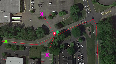

    The key thing to understand is that you want the lines from where people load/start the course (the magenta X's below) to be shorter to the first point (green below) than the last point (red below). In this case, having the end at the green X would work better.
  • Managed to go for my 1st ride of the year yesterday...........no rain! Anyway, I rode a course with the finishing point 50 yards short of the finish and had no issues at the start, so thanks for your advice!
