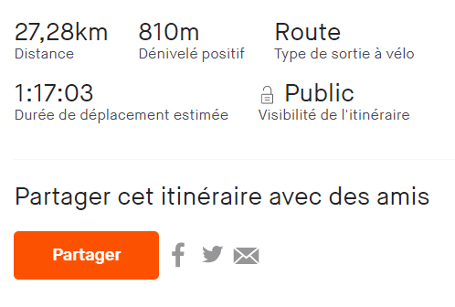

    1) Route creation : Strava route : 810m elevation

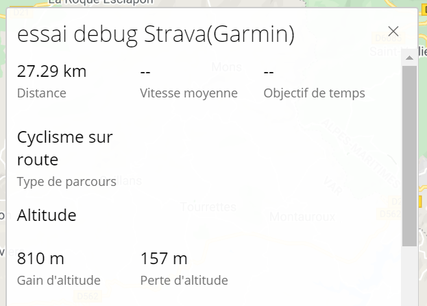

    2nd step : Garmin route as visible on the Web : still the right elevation  ( 810m)
    3)  Garmin Connect on the Phone Apps: still good ! ( 810m)
    Eventually , the route on my Garmin EDGE  830 device  after getting sync from Garmin Connect:
    so, the elevation issue  is not visible in the Garmin Connect ,  but only on the Edge device.
