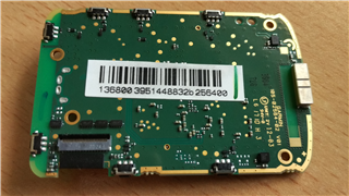

    and both sides securely connected ?

    I revised the conector, and I think all is correct. Nothing seems broken.

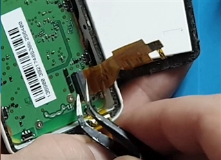

    sliding the cable into the connector it sits straight and not with an angle
    pressing the latch this closes firmly over the complete connector
    make sure the contacts on the cable were clean and not touched

    I put straight the conector and the situation doesn't change.

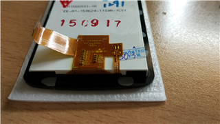

    This is the conector of the old screen:

    The metal strips are fine, I check and none are cut or dirty.

    Problem solve.
    With the garmin of my friend, the screen works correctly.
    The problem was in my garmin's motherboard.
    I was thinking in buy the Edge 530 because I thought that it hasn`t solution, but I put sticky tape in the back of conector to get that the conector stays tight and it worked.
