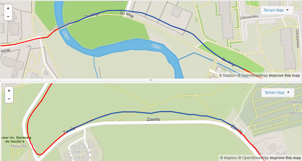

    Hi All! I`m new to Garmin community as recently bought the 520.
    I`m also struggling to get reliable gps tracking by the unit. Now it is my second unit after replacement under warranty. Mostly it is spot on (especially when sky is clear). Still there are times where 520 misses the track completely or shifts it around the corners.
    Bad weather (cloudy) and uphills with nearby trees/forest mostly affects the device. My old smartphone has never missed in such manner. Thanks to ride with friends I do have tracks from other Garmin devices and smartphones to compare at same time and conditions.
    Attaching the screenshots with issues on second unit:
    http://szosa.org/uploads/monthly_05_2016/post-13275-0-23799900-1462905282.jpg
    ^^ Cloudy and foggy morning with GPS+Glonass. Off segment completely. First unit did same thing on this uphill on cloudy sky (edge 500 did fine).
    http://szosa.org/uploads/monthly_05_2016/post-13275-0-25240400-1463168072.jpg
    ^^ light rain afternoon, GPS only after several Master Reset procedures/updates and leaving unit on for 11h to update its satellite cache.
