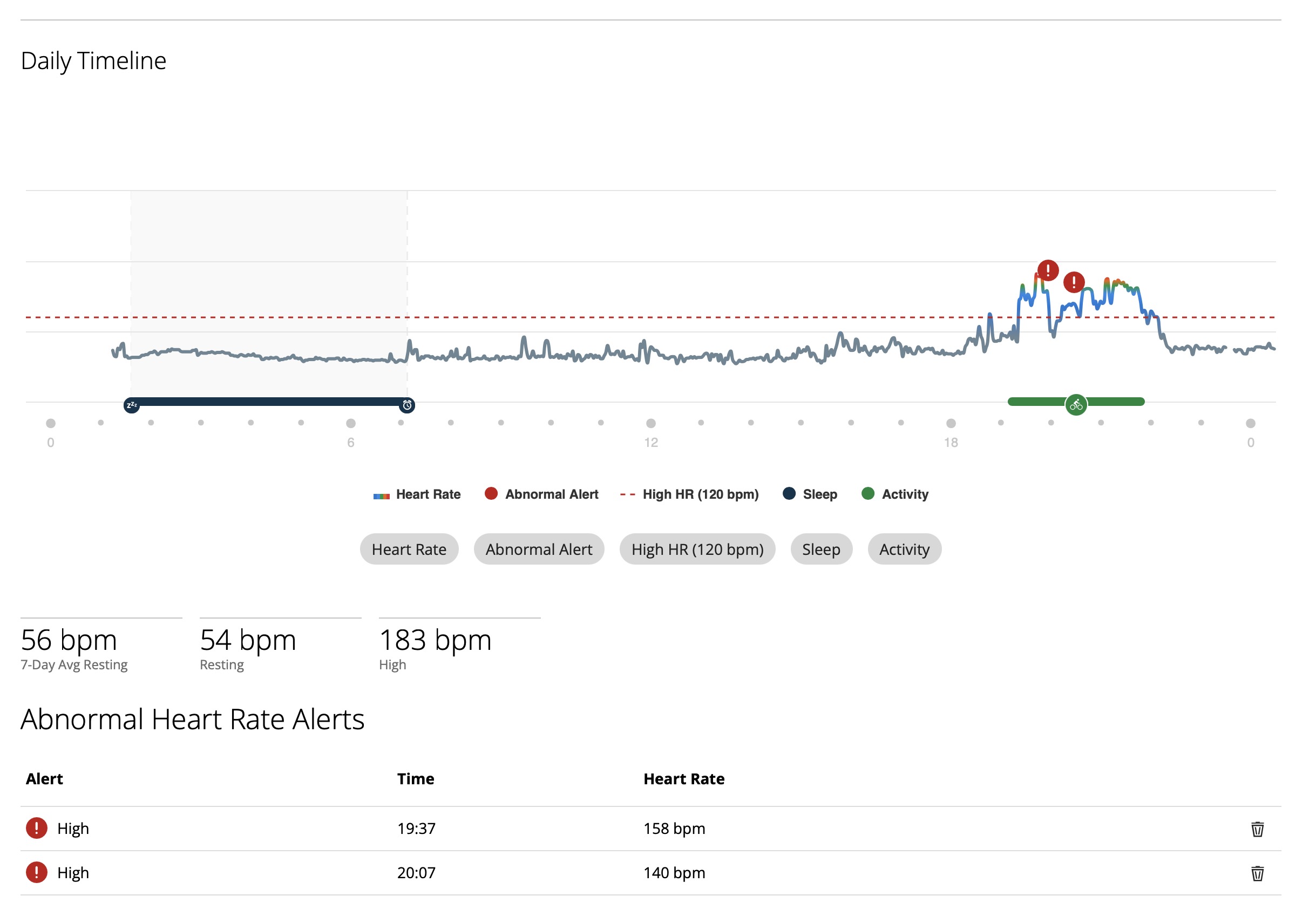

Hello,
I’ve been experiencing an issue where my Garmin Forerunner (currently worn) starts randomly triggering "Abnormal Heart Rate" alerts during steep climbs while I’m riding my bike and recording the activity on a Garmin Edge 1040. These alerts seem to appear without any basis, as I feel fine and my heart rate is consistent with the effort.
Both devices (Edge and Forerunner) are connected to my iPhone via Bluetooth, and Garmin Connect is open on the phone. I’ve tried recording the activity with the watch as well, but that causes major conflicts: sensors go haywire, and devices like the Varia radar and smart lights stop working reliably.
This behavior is disruptive and affects the accuracy and usefulness of both devices. Please advise if there's a way to disable these alerts when the watch is not actively recording or if there's a known bug involving multiple Garmin devices connected to the same phone during rides.

  • This is what normalization of failure looks like:
    Timeline
    Two “Abnormal Heart Rate” alerts by the Forerunner 965, while recording a ride with the Edge 1040.
    What’s worse: this timeline is generated by Garmin itself. No reconciliation. No adjustment. Just raw data passed as valid — even when the contradiction is visible from a mile away.
    My Forerunner is set as both primary wearable and primary training device. That gives it arbitration power — if data sources conflict, its version is considered the truth.

  • You can also let the activity run alongside your 1040 on your FR. Then you kill two birds with one stone: you are rid of your abnormal heart rate alarms and you feel your Varia notifications on your wrist. Unless you are the exception who can hear the beeps of the 1040 above the surrounding noise, thats also an advantage from a safety perspective, so you can fully focus on your KOM matters without getting frustrated for the 101st time.
  • Thanks for the suggestion and I appreciate the intention.
    This issue has been bothering me for years — and based on older threads that were quietly closed without resolution, it’s clearly affected quite a few others as well so I’ve tried the dual-recording setup many times, hoping for better results — but the outcome was consistently unpredictable.
    Initially I didn’t try this as a workaround: I genuinely thought this was the intended way to use the devices. Start the activity on both the Edge and the Forerunner, and they’ll work together, right? They’ll combine sensor data, correct each other’s errors, and improve accuracy through some kind of magical sensor fusion.
    Oh, how wrong I was.
    In practice, what I got was complete unpredictability: — conflicts, dropped sensors, accessories going haywire. I ruled it out in the initial post:
