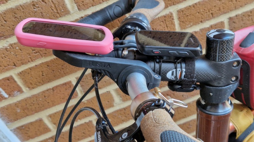

    This photo shows the location of the devices (1040, 530 and Tempe). It's possible that the silicone case I put on the 1040 (a modified 1030 case) because I dropped the 1040 on it's first excursion (slippery edges) reduces the amount of air cooling.The Tempe is on the underside of the stem where it's mainly sheltered from the sun and gets a bit of wind when the bike is moving:

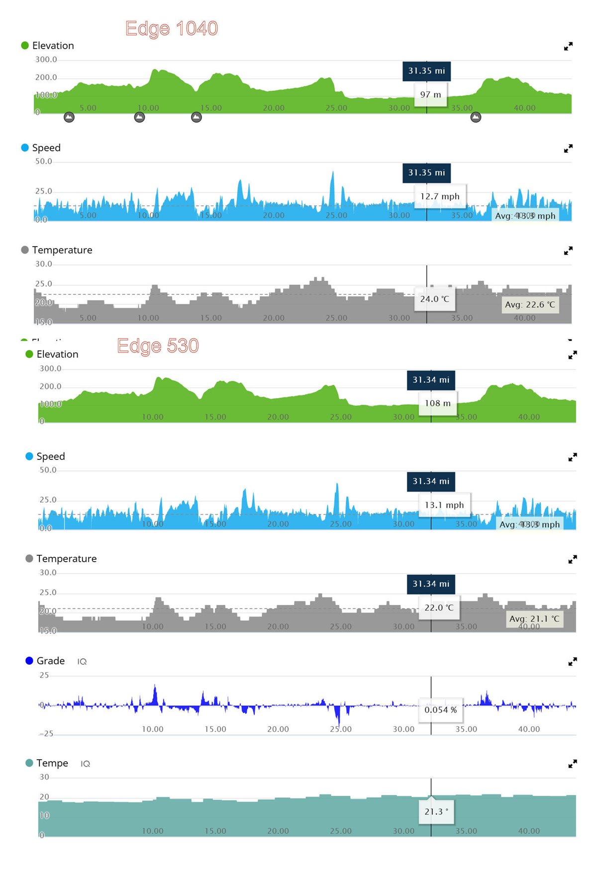

    The top three rows in the graphic below are for the Edge 1040 (including the reported temperature) and the bottom 5 are for the Edge 530 (including both the reported temperature and that measured by the Tempe (which includes a +2C correction which I've found gets it correct in cold and cloudy conditions with no solar heating)). It's clear that the Edge 1040 fluctuated most and the Tempe fluctuated least. However, I think the Tempe is only read once every 5 minutes so it may miss the extremes.
    It was also noticeable that the highest temperatures on the Edges were when I was cycling uphill in the sunshine when there would be minimum air cooling.
    After the ride I left the bike, with the devices, in the shade for 1/2 hour, and then did a very short ride so I could log the temperatures. All three devices recorded 22C at the start of that ride which is very close to the ambient temperature at that time.
    If logging fairly accurate temperature matters then using an external sensor placed in a shaded location is the only solution.
  • Nice analysis. the position on the 3 computers, differing mounts update frequency on the tempe and the case on the 1040 means this is not a direct comparison, but about as good as you could do. i think 1.5c difference in this scenario is ok. The fact all 3 show the same temp in the shade shows that that software and sensors are likely the same. It's down to the position on the bike. Most people go out front mount, in the wind.
