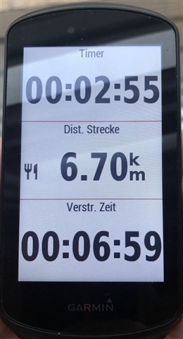

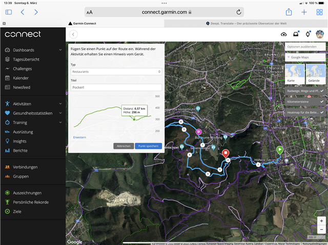

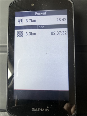

  • If you create your route with the Garmin Connect course creator, you can add course points in that interface. When you transfer that course, wirelessly using the mobile app, the course point is embedded and will show in the data fields. It is very simple and no need to ever use USB nor create files. If the ride is already in RWGPS then export it, import in Connect, add the course points there, and transfer to the Edge.
