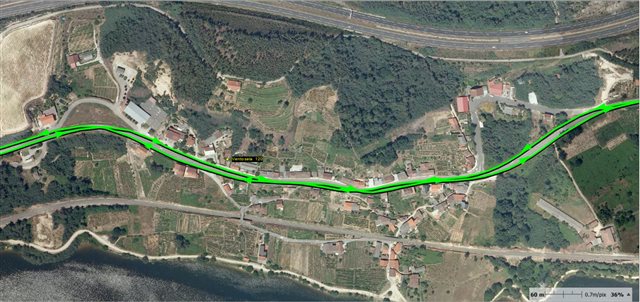

With the 8.00 firmware, this option has stopped working correctly. Here is an example:
The first image is with version 8.00 an 'lock to road' activated. The track seems to want to follow all the deviations it finds.
The second is with 8.00 and the option deactivated: the track is correct.
The third one is recorded with 7.30 and the option activated: the track is correct, it focuses on the road that I am really following, it does not go by detours.
The first two are round trip, the third only one way.

  • It seems to me that we are not understanding each other.
    The images I put correspond to the same route.
    The first and third with 'lock to road' activated (firmwares 8.00 and 7.30). As you can see, in the recording with 8.00,
    the track goes where it feels like it, it doesn't really follow the route taken.
    It is as if he wanted to leave for every detour of the road he finds.
    The correct operation is the third, from 7.30. The generated track correctly follows the path taken, but "smoothing" the path.
    Therefore, version 8.00 does not correct anything, but instead puts a new bug.
    You says:
    "Maybe, you two should swap units" No. All units (with version 8.00) work the same. All with the same bugs.
    Yes, yours too.

  • No, it's not about that, I insist. I return to the example of the images.
    The first one with 'lock to road "activated, the second deactivated.
    As you can see what is recorded is different.
    The correct one is the second one (and the third one, with 7.30).
    With 8.00 and' lock to road" activated, a track that does not follow the actual route,
    but deviations are invented (those that are found on the road),
    and it is not a matter of GPS coverage, they are not deviations of a few meters
    on the correct path, but a new path that is " invented " by the Edge
    Making assumptions of the deviations that I have taken. Notice that the lines that
    leave the path are not "random" but follow other roads that intersect with
    the one on which I was traveling
    . At no time have I left the general road, and ... you see what the Edge has generated.
    Nor is it a matter of a specific path, but it is something completely repoducible.
    All the records that I have made with 8.00 until I have noticed the bug,
    show the same type of error. I realized when following a segment he
    indicated "segment not completed",
    and I was aware that I was following it correctly.
