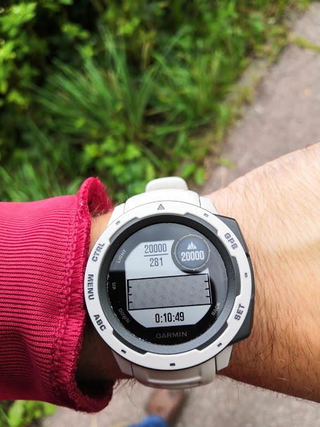

  • So I was on a walk. I held down the GPS search button. GPS found 281 meters. I saved my GPS. After squeezing the activity of walking, meters flew to 20,000 meters throughout the walk.
    After turning off the activity, I put the GPS search again and the meters were again 281 meters.
    I see an error during the activity. It shows the height incorrectly.The photo is taken while walking.
