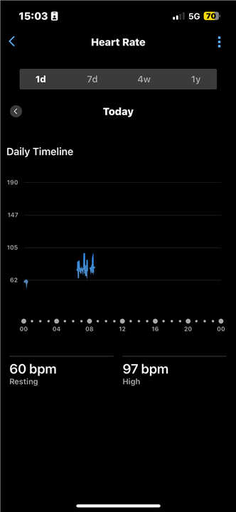

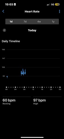

Well, the HR data is missing (except of a small period), and without HR the watch cannot make any sleep analysis. Do you use to turn it off, or do you use the Battery Saver feature? You can also try restarting…
At low battery, the watch may enter the Battery Saver mode automatically, and turn off the sensor, so if it was really low, it could be the reason
Could you post a screenshot of the all-day heart rate graph? Did you sleep within the bed & wake up times?

I slept within the times- I woke up 15 min before wake up time and I switched off the sleep focus.
Well, the HR data is missing (except of a small period), and without HR the watch cannot make any sleep analysis. Do you use to turn it off, or do you use the Battery Saver feature? You can also try restarting the watch, and Remove and Add a Device From the Garmin Connect App, wait till the next morning, sync, and see whether it helped.

Hi, I followed all the steps, but unfortunately the issue still presist.The interesting thing is when I fall asleep, the heart rate is monitor stops working and shows no data. I made a screenshot.
Does the HR sensor on the back of the watch emit any light at night? Do you wear the watch normally attached to the wrist during the sleep? Did you double-check that the Battery Saver and the Stealth Mode options are not on?
