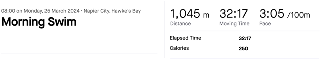

    Here's the GPX upload compared to FIT file for that rough as boots swim the other day. For me the most interesting thing here is that Strava increased the distance by a 23m but shortened the moving time. The elapsed time remains the same.
    The differences are minor and have been minor irrespective of the distance covered.
    I've done this comparison on a few occasions when people comment about the accuracy of Garmin's swim algorithm. For me it works. And I cannot believe I am the only person swimming with a Garmin watch that does not have any complaints about the accuracy.

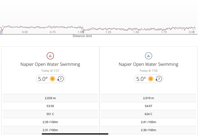

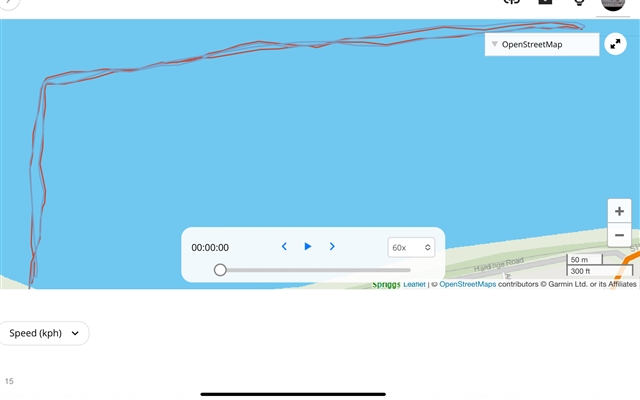

  • Swim this morning with instinct 2 X Solar and Epix Pro 47. Water was 12C with slight ripples. As you can see, very little difference between the two. This is not unusual for my swims and I'm swimming several times a week in the sea.
