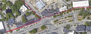

  • For the I2X, here it shows me running through buildings:

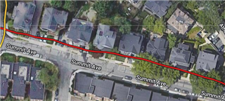

    For the same section chunk on my Epix 2:

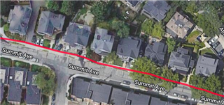

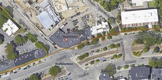

  • The accuracy of the technology is +/- 5m in good conditions, so that's perfectly OK. The deviation may come simply from the fact that you have worn each watch on a different side of the body, or that each of the watches locked on slightly different set of satellites. The fact that the deviations are apparently worse for the Epix, when running in the opposite direction near buildings, rather supports that suspicion. Have a look for example at the section a bit further, where the houses are also from the northern side, while running oppositely. Your Epix 2 shows that you have been running through the front yards, which I assume was not true. In contrary, Instinct 2, shows a more realistic path on the sidewalk:
    Epix
    Instinct
