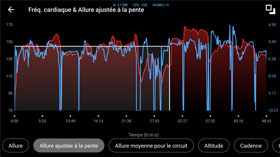

    I ran for a test: first run was endurance for 40min. Seemed ok at first, I mean "seemed to match the effort" but sometimes showed like frozen HR. And around 30min running, a HR 15-20 bpm higher than I was "feeling" : showed 168, I'm pretty sure I was around 150-155. But it was not a scientific test, only based on my own experience.
    Red is measured HR, blue is "adjusted pace according slope" (don't know the english garmin expression)
