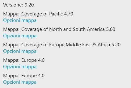

  • How can I update to 2018.10? When connecting the 5x to Garmin Express all maps are shown except OPEN CYCLE MAP!?!?! 16.2 can be found on watch directly but it is not listed on Garmin Express!?!?!
