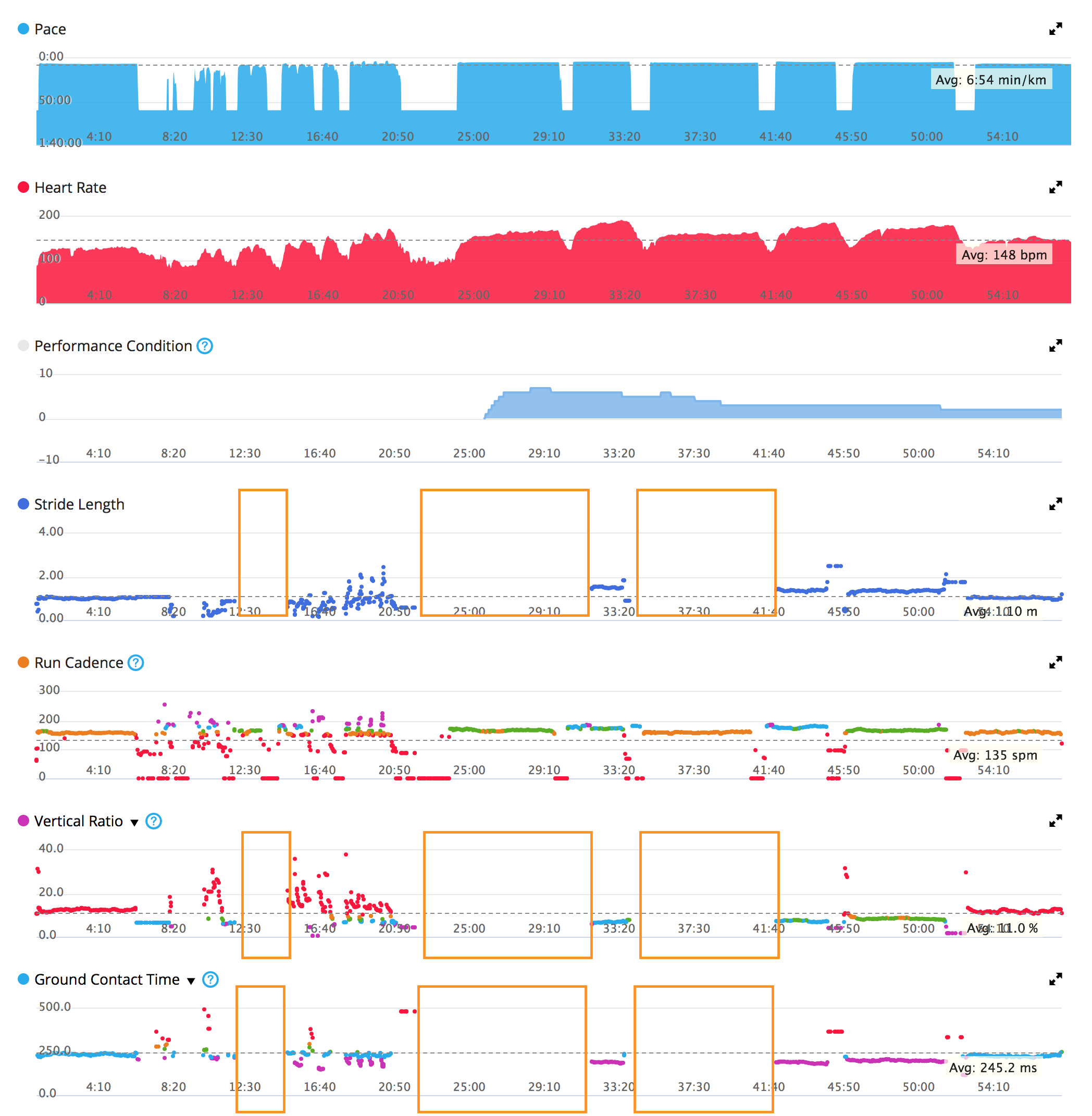

  • This was what my data looks like today. Heart rate dropouts as well as running dynamics dropouts. (On 2.96)
    I think my Fenix may going back.
    That's what mine sometimes does too. Is there anything significant about the points of the drop outs? Were you walking on an interval rest for instance?

  • I can reproduce the issue now with 100% reliability: While holding the Fenix 5 within direct line of sight and within about 6 inches of the HRM TRI (e.g. typically while running) I have no dropouts and everything works perfectly. The moment I take the Fenix further away (e.g. next to my side while walking) I immediately lose running dynamics data entirely and heart rate data becomes unreliable.

  • In my case, GPS seems fine. It is ANT reception that is the problem. As the issue is most pronounced with running dynamics I cannot use my older Garmin Soft Strap or 910xt to test whether the issue is the Fenix or the HRM TRI.
    This definitely looks like a hardware fault to me so I would first want to exchange it for another unit (if all else fails) - I really like the Fenix 5. However, at the price it should work consistently and I am really tired of going on walks and runs just to troubleshoot why the product is causing issues. I will try an contact Garmin support later today and will let you know if I learn anything new.
