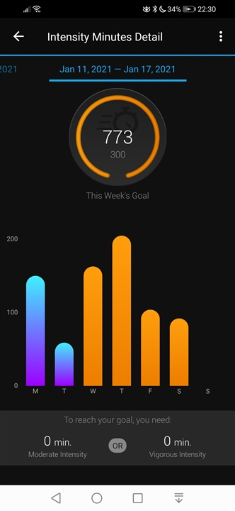

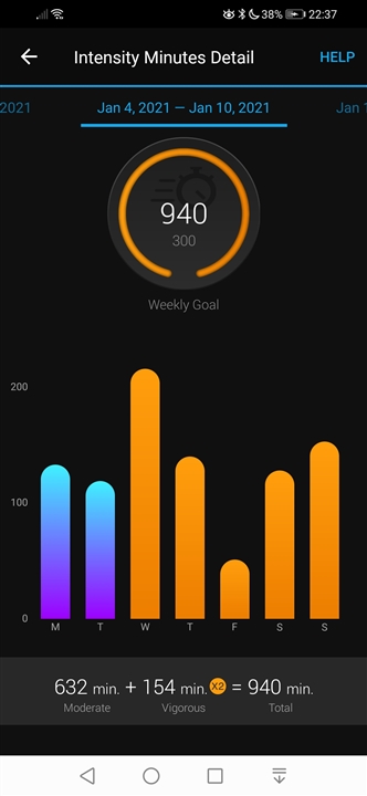

    Intensity minutes work even without Heart rate monitor.
    With the cold weather I've been turning the HRM off as I'm wearing the watch over gloves, I get even more intensity minutes. It's as if it records intensity minutes due to activity minutes because it has no heart rate data.
    Example.  I noticed this through the summer as well, when I had heart rate turned off to save battery, my intensity minutes went though the roof.
  • The week before was even crazier for recording intensity minutes despite heartrate data turned off for most activities.
    And the fact you turned off the HRM is exacty the reason for it. When there is no HRM, the IMs are calculated on the basis of steps, instead of the HR.
