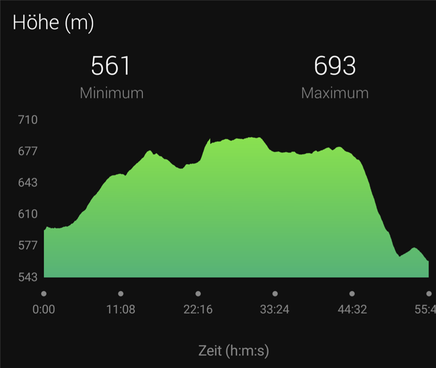

    Thanks for this useful thread. I “upgraded” my Garmin recently from a Vivoactive HR to the Instinct because I am running a trail race for which I wanted an independent GPS. I live in Illinois and have been doing hill repeats on the same sledding hill, basically charging the hill. I have been very frustrated with what it displays. All five of these are the same hill which is at the same elevation. Running up to the same spot and turning around. There shouldn’t be a slow descent happening. There should be five even distinct peaks and flat space. Instead it looks like I’m going mostly downhill. In between the first and the second repeat, I walked a lap around the park. It’s flat as a pancake. I thought maybe smoothing was an issue so I went to the train station and ran stairs in the evening. Same issue. At the end of my night it said 35 flights up and 47 flights down. On the stairs it was only counting about half of my climbing and all my descending. I’m so frustrated.
  • Hi Artgrrl,
    From my experiences what you observe has the same origin as the "smoothing" issue: I also have (almost) systematically a slow descent of ~25m during the first 30 minutes of my runs.
    Note that you can recalibrate the barometer with gps during your run. This will update the elevation but not the ascent/descent of your run, leading to odd things such as global ascent < elev max - elev min
    When I don't wear the watch on my wrist (eg in my bag) I don't observe this. And yesterday I tried a home-made dirty gadget (piece of plastic with tape) and elevation profile was perfect, both for smoothing and these 25m descent.
    However the tape itself was not sweat proof and stayed on my wrist when I took off the watch... So I really hope that Thomass001's gadget will work !
