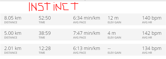

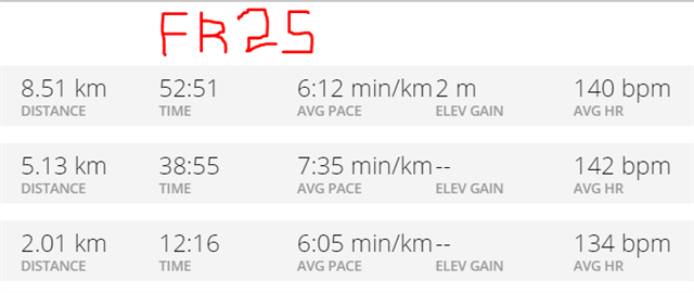

    Here are my results on the first 3 runs:
    All runs were made wearing both watches, Instinct on the left wrist, FR 25 (paired with HRM chest strap) on the right wrist here are the discrepancies:
    1st: -1.63%
    2nd: -2.72%
    3rd: -5.71%
    I must say that Instinct settings were GPS and "smart" recording. Will set it to 1 second recording to see if there are any improvements.

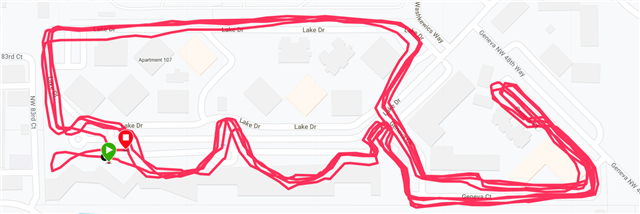

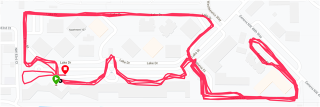

    You could see on the map that the track from the Instinct runs cut a lot of corners and are a lot more rounded than the FR25 ones. Here are some images.
    Instinct map:
    FR25 Map:

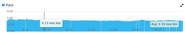

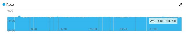

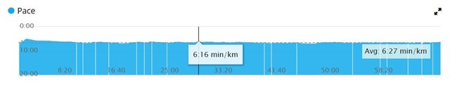

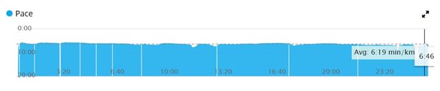

  • Hi, I wonder if this is what you mean and if you found a solution to it. Also if someone else has this same thing happening to them, here are some screenshots at the "intermittent not recording 1 second"  runs were 10K, 10K, 21K, 8K, and 4K respectively.
  • Note the amount of times the pace chart shows no recorded pace, I'm no expert, but this should not be normal.
    I'd highly appreciate any feedback to determine if this happens to everyone or if I have a defective unit.
    Thanks in advance for any comments.
