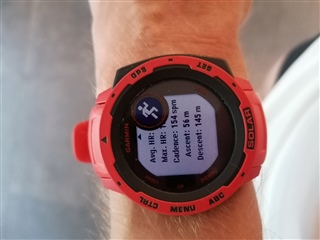

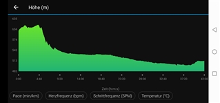

To me the altimeter in the Instinct Solar is useless. Maybe I am using it wrong, maybe its a bug? Please advise.
I used to be unsatisfied with my Polar M430 (only GPS) showing a +-40m elevation difference on a +-30m run.
A pro. tri-athlete colleague at work told me that's actually pretty good. To get more accurate measurements I need a *barometric altimeter*.
Fast forward a few years and I buy a Garmin Instinct Solar.
I have not once gotten a reliable elevation measurement during a run.
To no avail I have tried calibrating before a run, during activities, watch mode barometer, watch mode auto, GPS + GLONASS, GPS + GALLILEO...
I run a loop, hence I expect ascent and descent to be the same, but they are wildly inconsistent. These are my last 4 runs (all along the same route):
Date orig. Ascent orig. Descent Adjusted in Garmin Connect Height profile
07.03 +26 -56 +-53
12.03 +43 -80 +-44
28.03 +50 -102 +-50
30.03 +42 -102 +-42
Also, is GPS not used for determining height at all? Even with "calibration during activity" I return far below where I started...
Almost every morning I rinse my watch with luke-warm water, focusing on the hole of the barometer.
Now I am running out of ideas. Is this normal? Help

    Since day one Garmin did not care about my concern and tried to downplay the problem. In a reply to my OP, where I described my disappointment with 60 m altitude drops during 45 minute runs, Garmin - Chris just said my values were excellent and I could always adjust my altitude in Garmin Connect afterwards (yeah, very useful for an outdoor watch.)
    What you are experiencing is considered excellent for a consumer grade barometric altimeter
    My local Garmin support basically told me the same, "GPS-only would be worse" and "I should calibrate more".

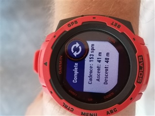

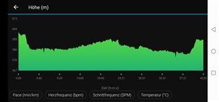

    I have had my my new watch for about two weeks and now I am finally  seeing consistent, good altitude values. Whether I walk into town and back or go for a run or bike-trip I end up at approximately the same altitude I started on. Sometimes I loose/gain 5 meter per hours of activity, once I lost 7 meter (see below), but it is typically only 1-2 meters.
    I had both watches (old and new) for a couple of days. Here is the result of my first run with both (same calibration settings, same GPS settings, both calibrated before runs, etc. etc...)
    Old Garmin Instinct Solar New Garmin Instinct Solar
