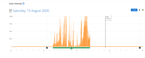

    I've checked the solar intensity chart in GC. The sole intensity during my ride was from 50 to 100%. I'm collating it to similar but shorter ride. The solar charging looks broken.
    Please check it, test it. Do not answer that I'm just don't know what I see. The functionality should be not just marketing trick but reliable solution.

  • I've checked the solar intensity chart in GC. The sole intensity during my ride was from 50 to 100%. I'm collating it to similar but shorter ride. The solar charging looks broken.
    Comparing to similar, but shorter rides is not a valid test. You should do the same ride, at the same time of the day and there should be the same amount of clouds in the sky. Also, you should wear the watch exactly the same way as you did before, as even the smallest change in angle will cause the bezel to cast a different shadow over the display witch affects charging a lot.
    As an example, I rode a bike on Saturday under bright sun. During the first 1/3 I was under blue sky with no clouds and no trees or buildings around at all. I was expecting to get 100% during that period, however this was not the case, as you can see on the screenshot below. Why? Well, I realized as I was going along the road, my body and arms (and the watch itself) were sometimes casting shadows over the display. Also, the display was usually not orientated towards the sun, because I was shifting gears, turning the handlebars and moving my hands in general, which affected the angle between the sun and the display.
    To my surprise, I got most sun power at the end, when I was back in the city and I was certainly trying to ride in the shades as much as possible.
    I would say, getting between 50% and 100% during your ride was a coincidence. You can't expect such high results all the time.

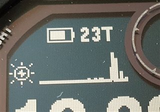

  • Is it then possible to use firmware 10.00 to choose whether the battery widget will display either the remaining runtime in days or percent? So far you can only display the days.
  • No, to see percentages you have to press longly to menu button and wait a second
  • Former Member
    0 Former Member over 5 years ago in reply to KarsiyakaRocks
    I am running 10.0 fw on my solar instinct, even after reboot I can't see any percentage when I press long on the menu button, it only show remaining days, I do not understand why. Any hint ?
  • After going to the first main menu, wait 2-3 seconds and you will see the dial in the top right corner change from days to %.
    Hope this helps!
