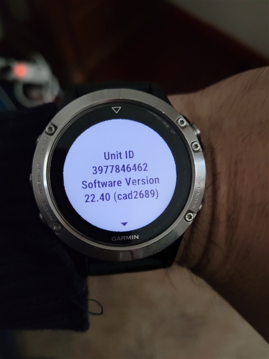

I've the correct file http://www.f-blog.info/GarminFirmware/fenix5_2371Beta.zip download it and then go to the folder systembackdate and put the Gupdate in the garming folder. When you unplug your garmin it will appear an update
This time it works. Unziped and followed the steps described. This "update" appeared on screen after disconnected the watch from PC. Install take about 2 minutes. I'll leave another comment soon about the battery life. Greetings!

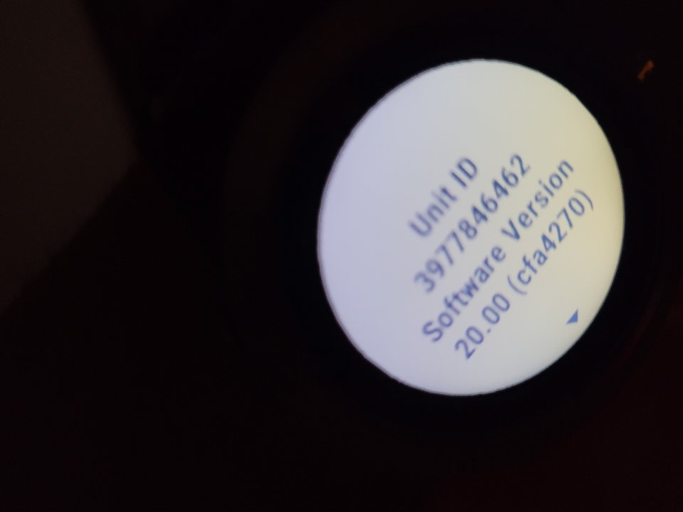

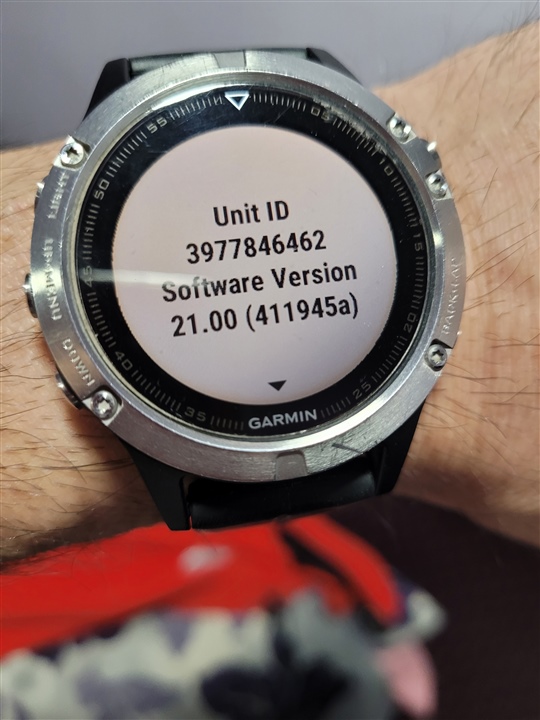

5% in 3h. This version of software isn't good than 24.10. From blog above I've got to more ofteare version backward 22.00 and 20.71. I'll try this evening and I'll post here conclusions. Greetings

No matter what the version of software are installed, the life of battery didn't improve a bit. I've got 23 22 21 but nothing changed.
Consumption is about 12% @8h no matter what I do, without BT connection
