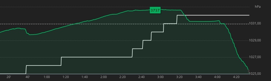

  • AllanOlesen67 i know what you mean. but let's say, it will do this on start, as long as it has a quite good altitude. then take a brake for lets say 15 minutes or even better 30 minutes. it would not really effect battery consumption and yes, is would give you a little jump up or down, every now or then.
    if the weather not change, there is nothing to correct. but if so, yes you would see a jump. as the suunto ambit series does, or the polar vantage v. (it would not be as smooth as the suunto spartan or 9 series,) but it would be the more correct altitude.
    lets take this an example:
    there is correction in air pressure with 7 hPa which equals around 56 meters of elevation along the way. the peak was of around 3 meters. where my watch was around 70 meters off at the peak.
    and lets say there are days you don't wanna take care and manually recalibrate your watch every now and then and just do sports or enjoy the mountains.
