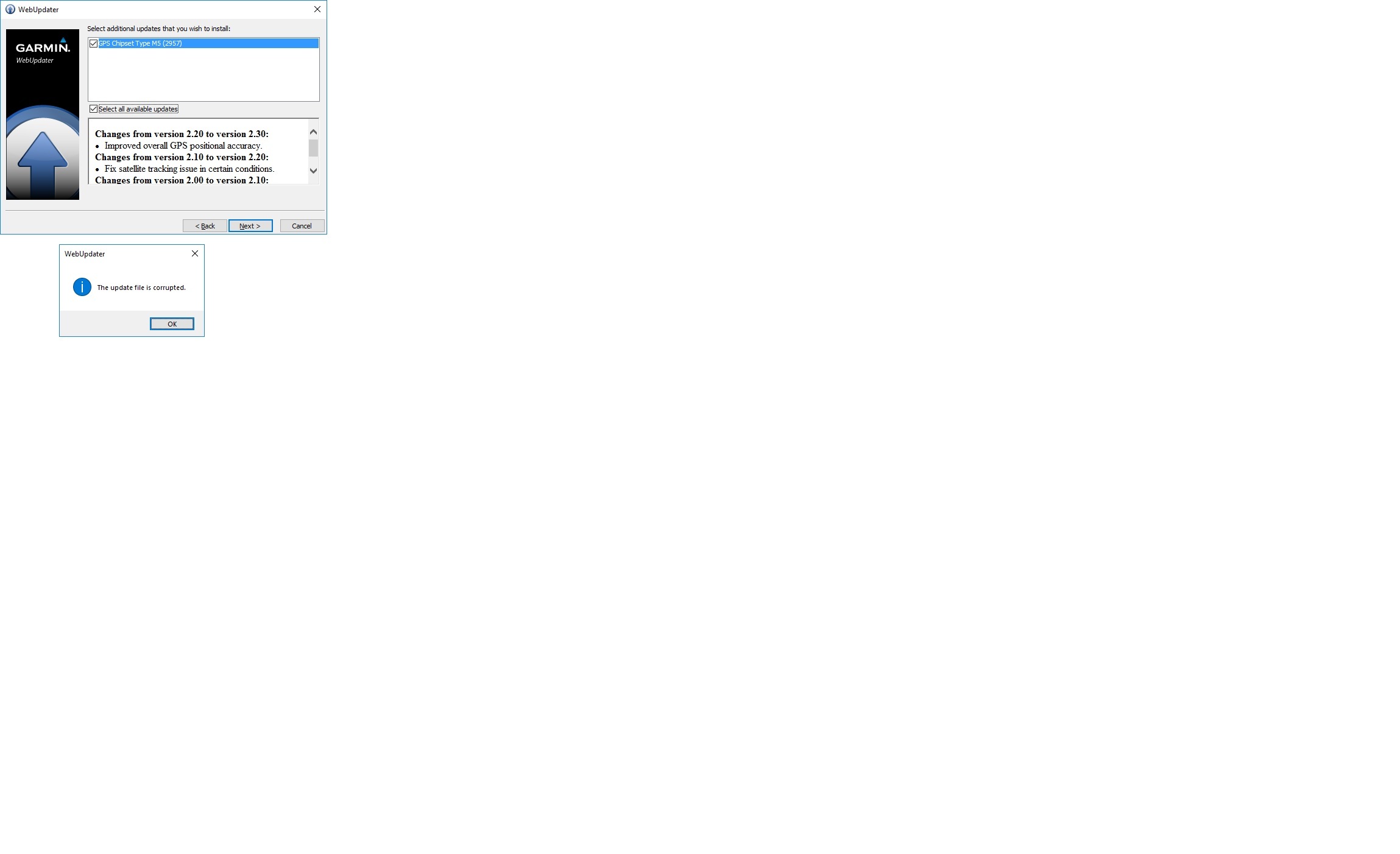

    Dang it! I installed WebUpdater. and It Identified that the GPS chipset has an update. but the transfer was aborted. The "Update file" was corrupted.
    I've tried this a couple of times.
    Ideas?ciq.forums.garmin.com/.../1412007.jpg
    Ideas?
    Sorry it didn’t work . The only difference for me was I used the Mac version but that shouldn’t affect the file update.
