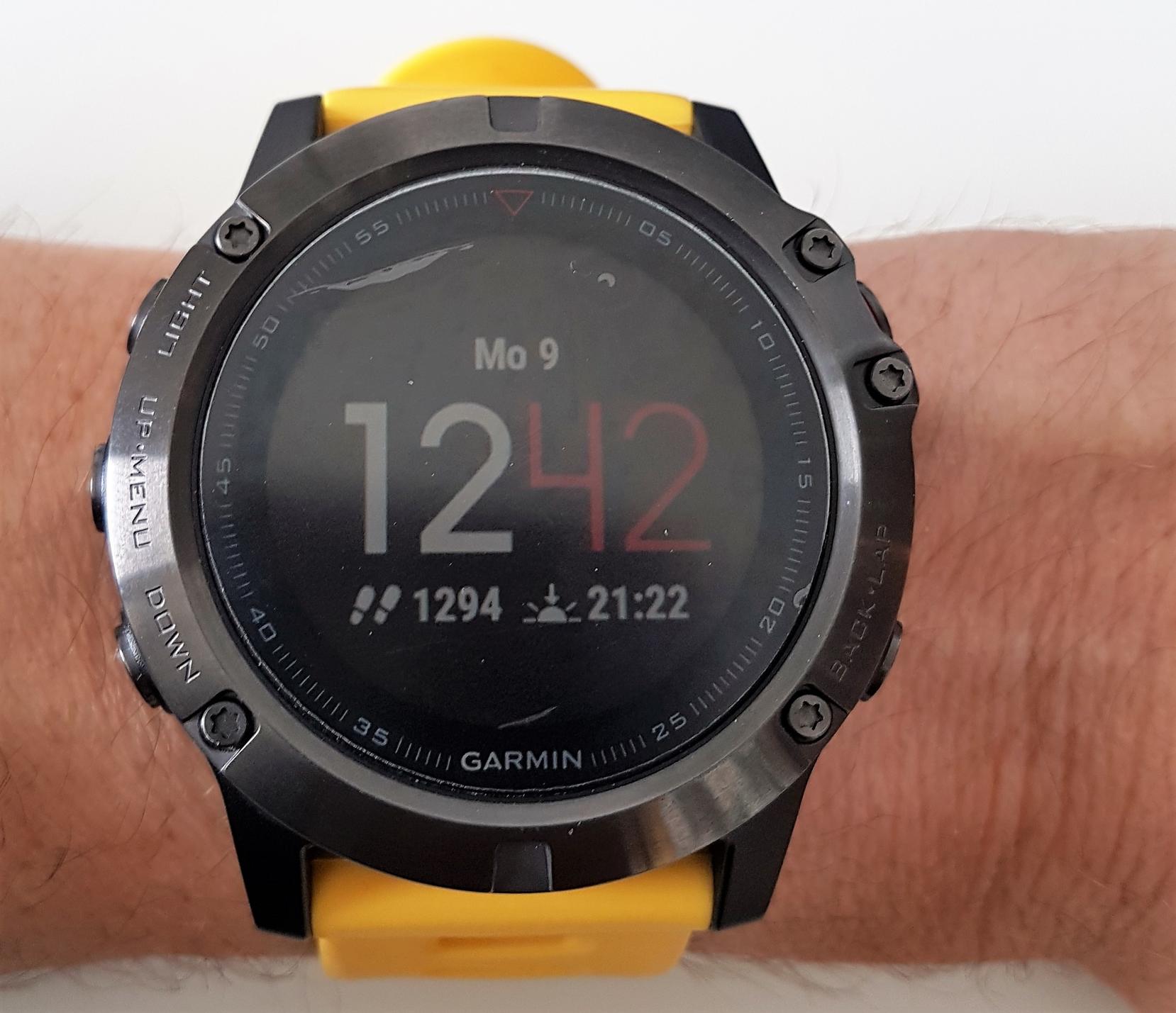

    wich watch face did you use when you had that performance?
    Also a stock one...
    Widgets: Heart Rate, Training Status, Stress, Steps, Calories, My Day, ABC, Last Run
    ciq.forums.garmin.com/.../1373204.jpg

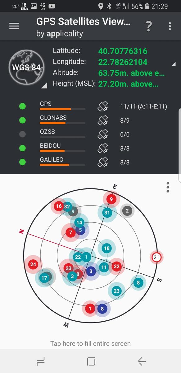

    Regarding the GLONASS vs. Galileo argument, the capibility of the sats is totally dependant on what is in your sky at the moment. If there are more GLONASS birds overhead, use GLONASS, if there's more Galileo, use Galileo, that just makes sense. However the challenge is how to know WHICH birds are in your area. I've found a good website that will show the positions, and future orbits of these sats, and you can project to see where they will be later. Of course, you do need internet access, but I generally will check before I leave home.
    https://in-the-sky.org/satmap_radar.php?year=2018&month=7&day=7
  • Less Galileo satellites, but I'm having better track against Glonassciq.forums.garmin.com/.../1373407.jpg
