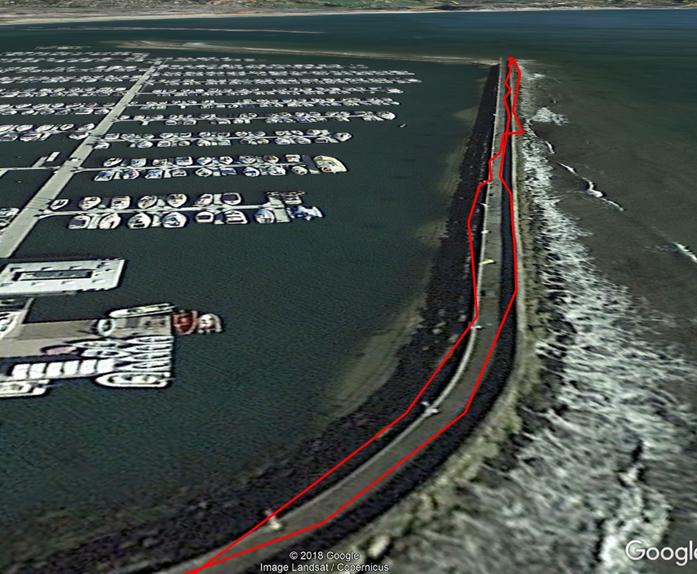

  • I am on FW 9.2 and GPS 4.40. Decided to see how 1 sec recording would work while out for a walk on a cement breakwall walking right down the center both ways, and visible clearly on satellite. While I normally use GPS plus Glonass on the trails, This Track Me was just GPS. It doesn't appear to display 1 sec intervals on this very simple exercise. Not too concerned but I switched data back to Smart as the data isn't any cleaner in the end in this example. I should test GPS plus Glonass and both Smart and 1 Sec but don't believe would be better from what I can see. Slightly cloudy day due to minor marine layer. When ocean paddling I always just use GPS since I am in clear view hypothetically. I expected to see regular interval data points and a much more accurate double track. Maybe due to wrist facing one way and then the other.ciq.forums.garmin.com/.../1366102.jpg
