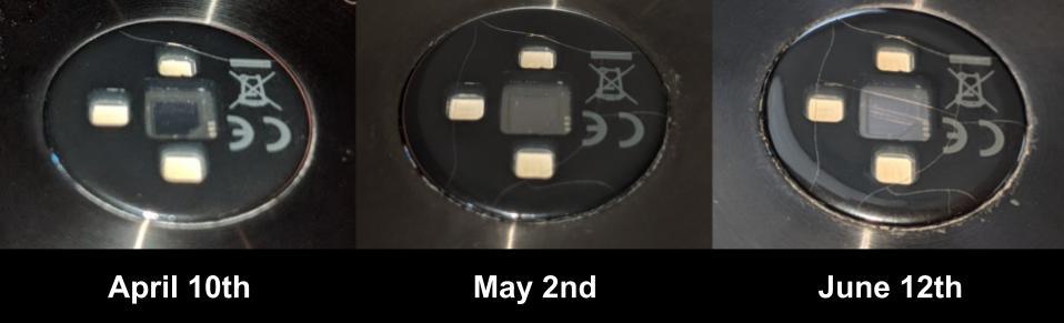

While charging in unusually dim lighting this morning, I noticed hairline cracks on the face of the HR sensor. Panicking, I did some research and found this has happened before to people (like me) who have not damaged the sensor in any way. I have not dropped, smashed, or otherwise done anything to the underside of the watch. It is on my wrist 99% of the time. Sent an email to Garmin support this morning and hope they can address the issue quickly. I love this thing and hate the idea of being without it. ciq.forums.garmin.com/.../1284467.jpg

  • Cracks are propagating as on the last one. I'm loathed to take this second one back to the store...but the crack has crossed the sensor now, which is when the last one started drastically under-reporting my heart rate. Already seeing signs of that - this morning I saw a sudden 12 point drop in RHR, checked the back and sure enough there's a crack right across the central element of the sensor (right-hand side of attached image).
    Knowing full well I'll have another broken watch in three months, I'm taking it back again. Not cool Garmin, please acknowledge your design/material selection error and put it right; this isn't some fun toy or gadget for me, I (and many others) rely on it for monitoring training load between races.
