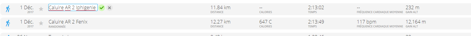

    Same problems : crazy altitudes !!
    Copie of two recording of the same activity to day : one from Fenix 5 the other from Iphone application
