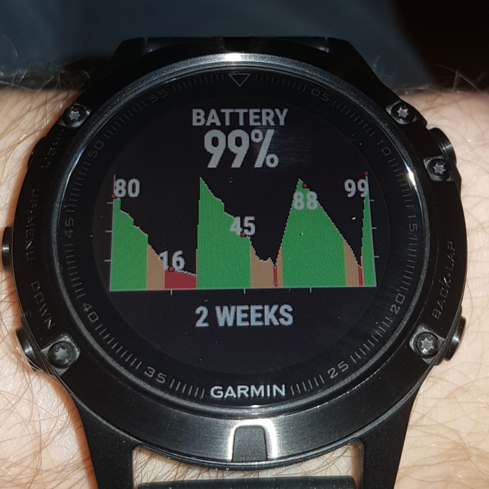

  • Hi everyone!
    I just had an easy week of 3 hours of running, and 40min of swimming.
    I charged the watch to 100% on Monday afternoon and already today Saturday morning the watch died. So approximately 5 days of battery life ????
    ciq.forums.garmin.com/.../1453290.jpg
