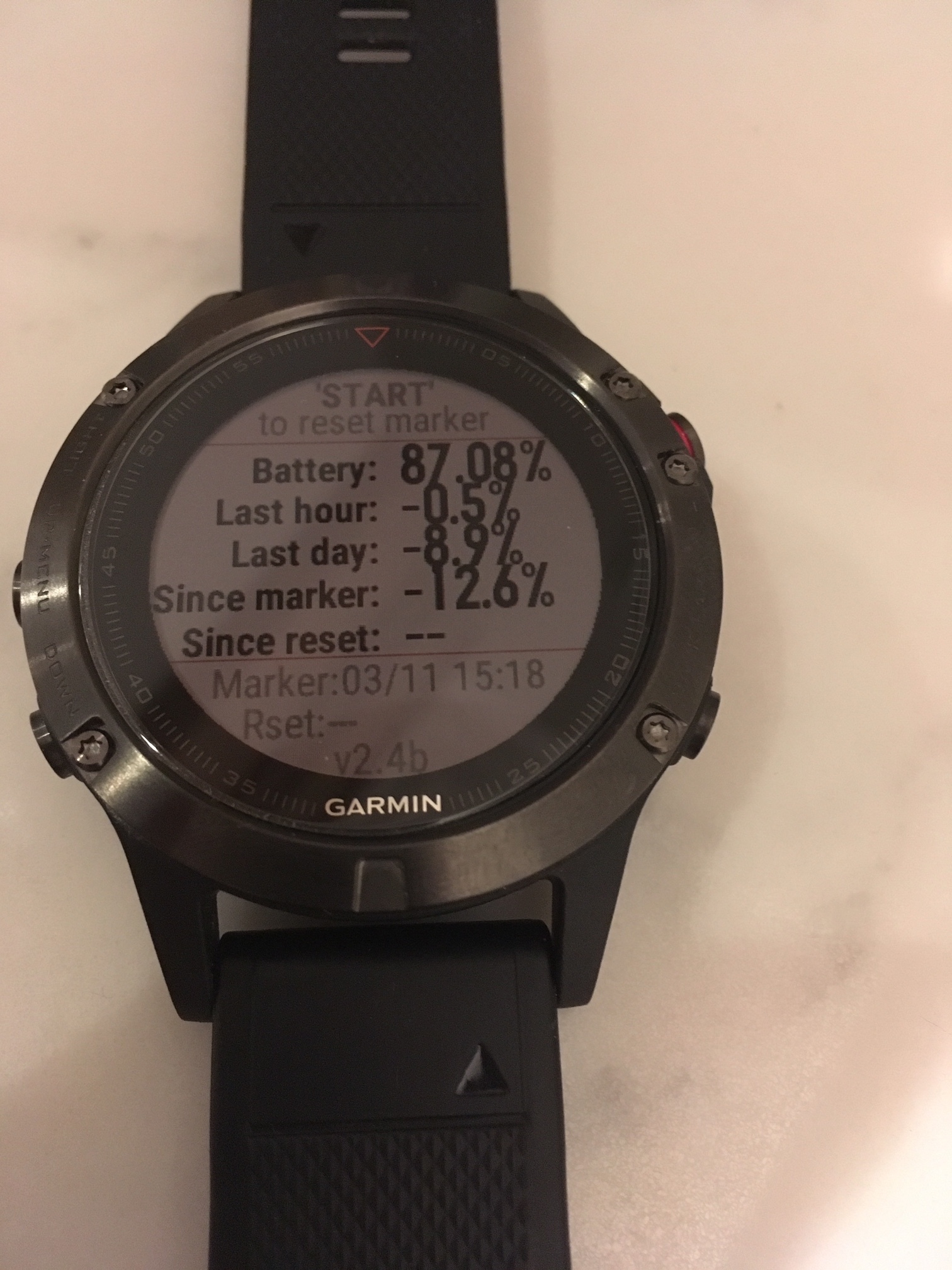

    I ended up speaking with Garmin, they suggested a hard reset, if that didn't work to send it back to Amazon("it'll be quicker than return to us") so I ended up doing exactly that after a reset didn't work. So yesterday I received the new watch(same 53 starting serial number). Battery was completely dead on receiving it so I charged to 100%, updated to v12, but one thing I didn't do that I did with the previous watch was enable anything which might trigger GPS to be active, specifically *not* syncing the time via GPS and *not* touching any activity which may use GPS. The results so far as very promising. After the first days use ~0.5% per hour vs ~1.6% per hour on the previous watch. Only question is whether this is because of 1. a new watch with better battery performance? or 2. not enabling any form of GPS which others have mentioned in previous posts may have something to do with the problem, in other words once GPS is enabled it continues to be active in the background regardless of the activity settings etc? I'll update if the battery performance changes from what I'm seeing now.ciq.forums.garmin.com/.../1445209.jpg
