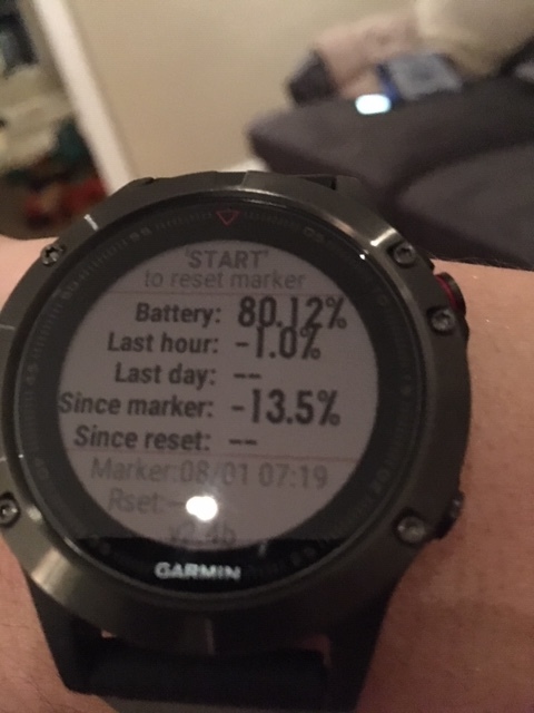

    Hi, I have a similar problem. I purchased a Fenix 5 last week from Amazon, upgraded the firmware to v12 first thing and have experienced poor battery consumption. I've tried a few things to try and improve it, using the Garmin digital watch face without seconds, disabled activity tracking, disabled HR, reduced the backlight brightness and timer, nothing has helped so far. I've tried a soft reset, I'm on my 3rd charge cycle and the problem remains so this isn't looking good. I re-enabled activity tracking and HR today and installed the battery gauge app to better understand the rate of consumption and it appears to be losing 1%+ each hour without any activity, whilst battery performance while in an activity seems good, so this is very disappointing. Unsure whether to return to Amazon or live with it.ciq.forums.garmin.com/.../1441870.jpg
