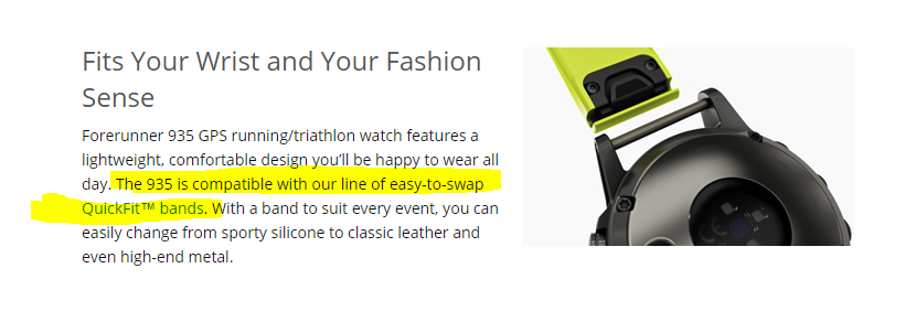

    I also need to correct my previous comment that the 935 doesn't have quick-swap bands! I was completely wrong, I just checked Garmin's website and realized the 935 is in fact compatible with quick-swap bands.
