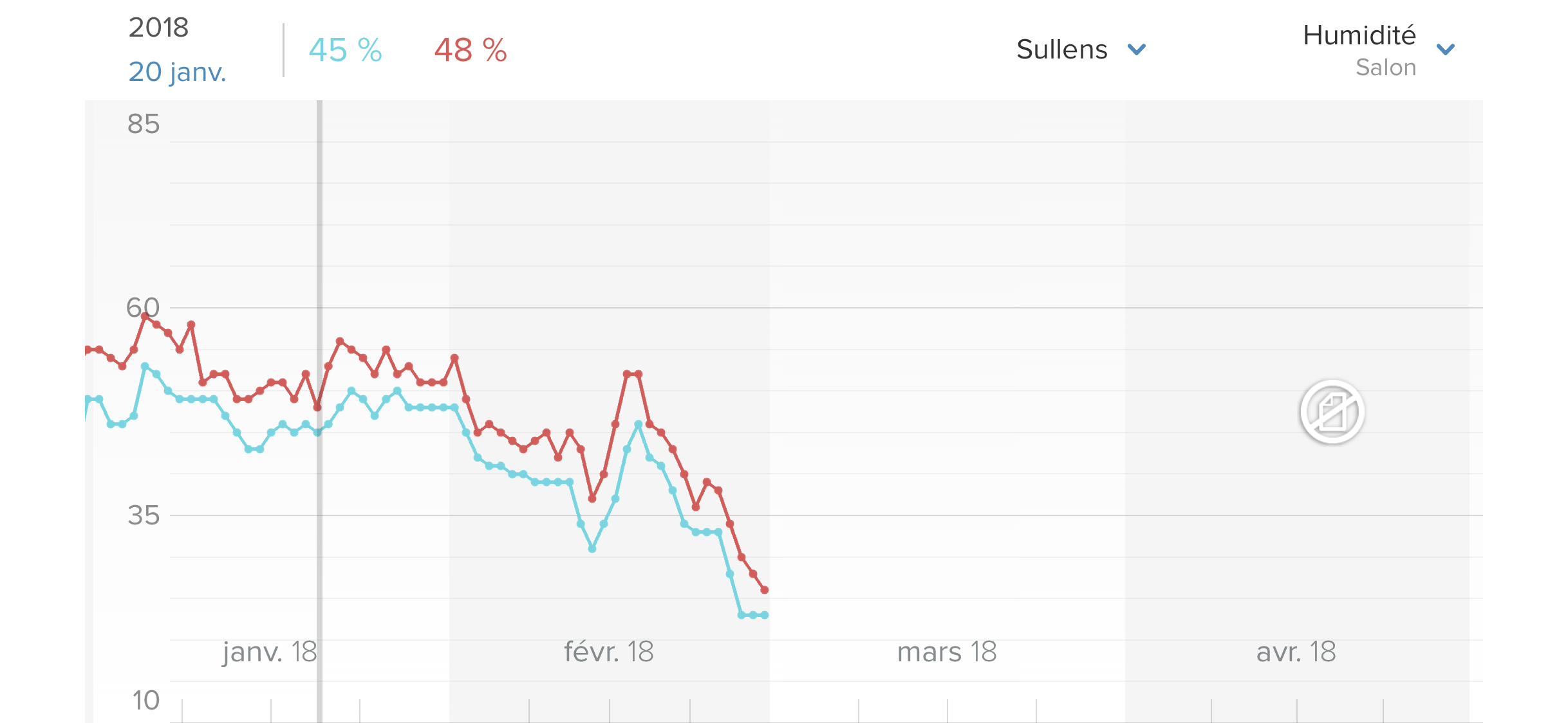

  • Hi all
    just a quick observation I made yesterday. The altimeter went crazy when I arrived at home the last 2 days. And the air in my home is very dry since the outside weather is very cold here. Relative humidity is now below 25% and as mentioned above, having water on the watch , the altitude slowly come back to normal.
    ciq.forums.garmin.com/.../1316203.png
