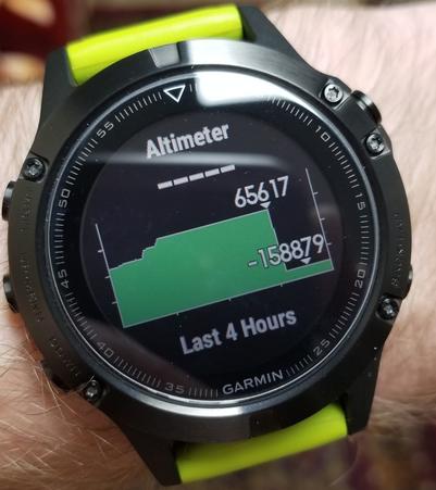

  • I've got you all beat. This is a picture of my brand new three day old piece of crap Fenix 5. This is my third brand new Fenix 5 since launch. The LCD on the first two failed but this one is the first one to have a failed altimeter, barometer, and temperature.
    I've performed at least 5 GPS calibrations on the altimeter today.
    I really like this watch a lot and held off on the Fenix 3 for years waiting for this one, so I will take it back to REI and get FOURTH NEW ONE. ciq.forums.garmin.com/.../1306252.jpg
  • I've stayed in auto watchmode for the last week or so with the new (3rd) watch and have had altitude spikes up to 65000 ft almost every day. I'm switching to altimeter mode today and will see how it goes.
    Changing modes will do absolutely nothing in your case. If you see 65000 ft spikes, you have a faulty reading from the pressure sensor. Changing to altimeter mode will not fix that.
