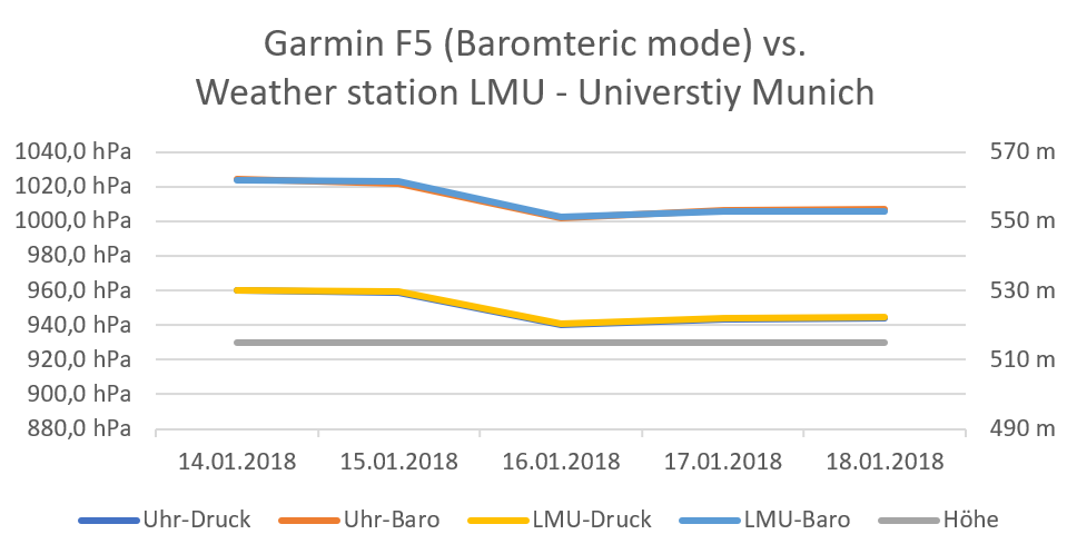

    @ SebLeclercq and AllanOlesen67 - You're both right :-)
    The explanation and my graphs gives and understanding that ambient pressure, barometric sealevel pressure and altitude are corelating and changing due different weather conditions. Furthermore - if the watch is in Auto modus – the recalibration feature try’s to assume if ambient pressure changes are a result of weather changes or geographical moves from the user. In many post her I have missing this basic understanding.
    The graph and the explanation also demonstrates that my watch is working well.
    It does not explain why my watch showed unrealistic altitude datas and Sea-level Pressure (as you SebLeclercq and many other user are reporting here) some weeks ago and what made the change to get correct result as I'm facing in the moment.
    What I have changed so far?
    • Update to 7.1
    • Removal of all external watch faces
    • keeping the gear away from water (no shower, no washing)
    I started my measurement and got the explained correct results. One time with Auto Mode (and you see some aberrations which Allan explained), one time on Barometric mode (I add the graph here in this post). The Barometric pressure to ambient pressure has a average deviation of 0,2 hPa or 0,02% to the scaled weather station of the university next door to me.

    Major thing is that we always have to check the ambient pressure (see post of AllanOlesen67 on 12-12-2017) to see if the sensor or the software is producing strange results.
