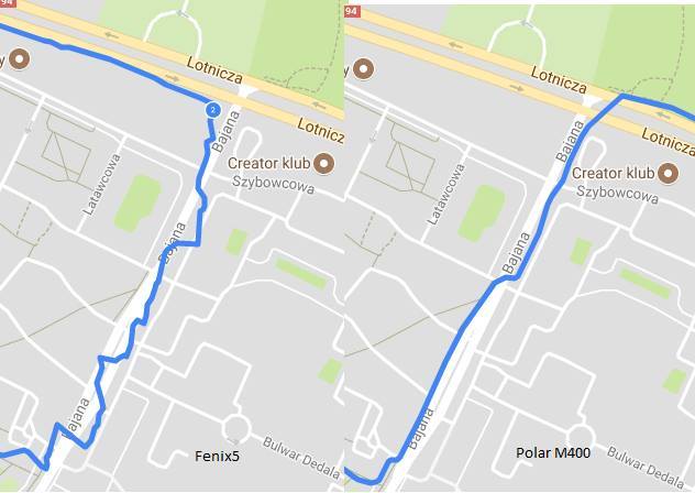

  • Hi everybody,
    can someone here explain me why so expensive watch like Fenix5 is doing like this, I mean much worse, than Polar M400?
    ciq.forums.garmin.com/.../1326789.jpg
  • Hi everybody,
    I agree.
    I've switch from Polar M400 to Fenix 5 as well and after a year of usage (and a lot of firmware updates) I see no improvement.
    It's so disappointing...

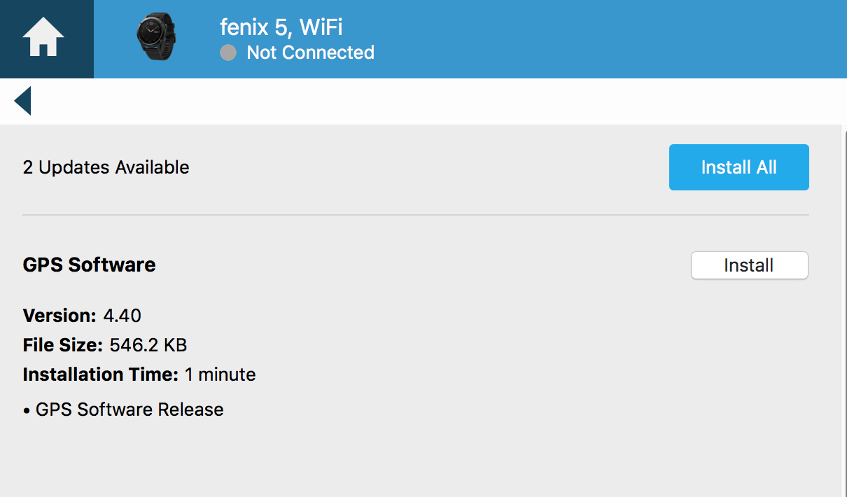

  • Finally!
    The GPS firmware has been updated!
    It's the first time in over a year that they've updated the GPS firmware!
    It was 4.30 since April last year and now it's 4.40.
    Hopefully the fact that they've waited a year before releasing this update is an indication of its quality.

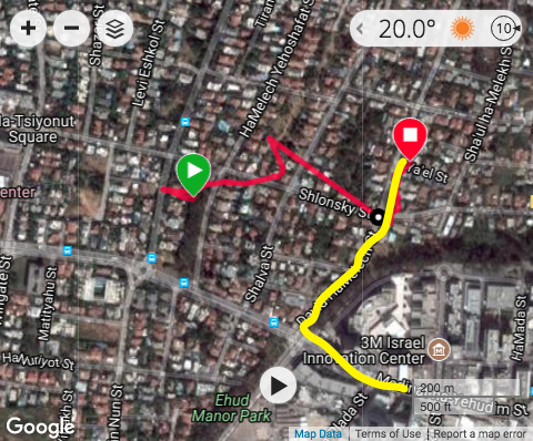

  • OK, so I updated my watch to GPS firmware 4.40.
    I started running and I saw that the drawn route makes no sense (I have Fenix 5, so I don't have maps, but I can still see the drawn route.
    I ran about 200 meters and the route was already at 500 meters.
    So I stopped the run.
    You can check the result in the attached image (the red line is what the watch generated, the yellow line is the actual route I ran)
    The GPS was WAY OFF!
    It's never been this bad!
    It's so bad that the start point itself is wrong.
    As always, I waited enough time after the GPS fix.
    I use 1 second recording with GPS only (which I found produces the most accurate results on this watch)
    This is so disappointing!ciq.forums.garmin.com/.../1341394.png
  • The first activity after updating the GPS software are often poor (long time to get initial position fix too) as the update wipes the GPS Almanac data and it takes 10-15 minutes of good GPS reception to get the data again. More discussion here https://forums.garmin.com/forum/on-the-trail/wrist-worn/fenix-5x/1339005-software-update-for-gps-4-24-18?p=1339716#post1339716
