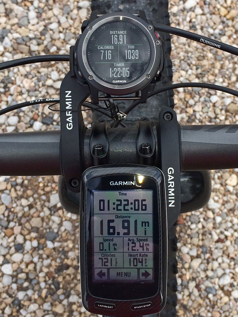

  • It's certainly possible to use many devices simultaneously when biking:
    Great for comparing accuracy and consistency of tracking and data recording.
    In Garmin Connect you will have to choose one device for the Bike activity record, but you can keep the records from the other devices, just re-name the activity to "Uncategorized" and you will be able to review all the data without the results interfering with your overall cycling data summaries.
    HTH

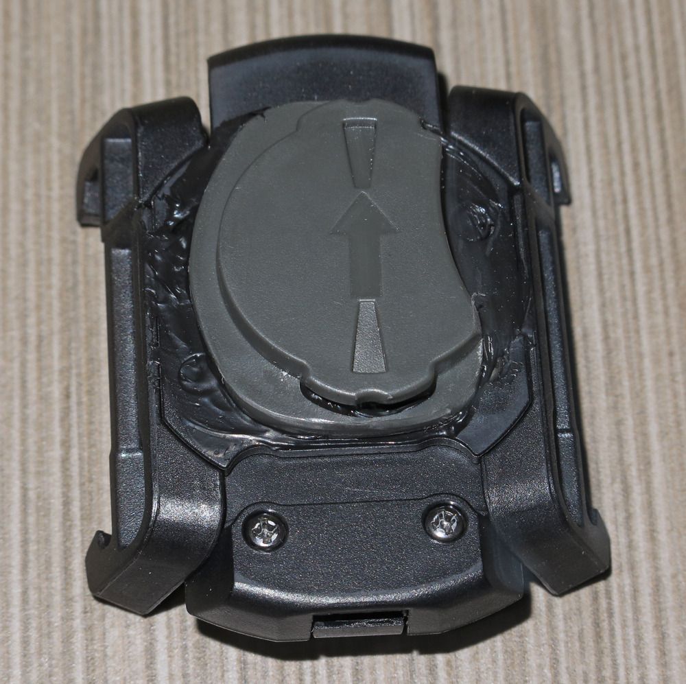

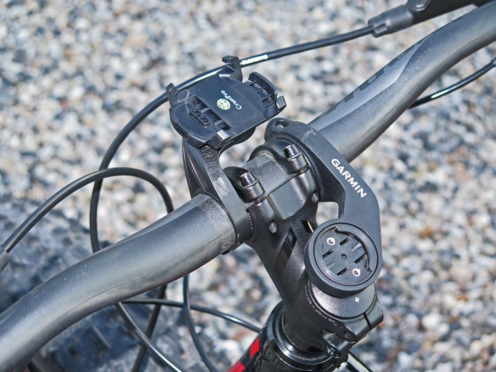

  • I have that quarter turn thing on my Edge 520.
    Will that thing work on a Fenix 5 when you take the bands off?
  • I added one of those quarter-turn thingies to a fenix 3 charging cradle:
    Looks like it might work for the fenix 5, but can't tell for sure:
    HTH
