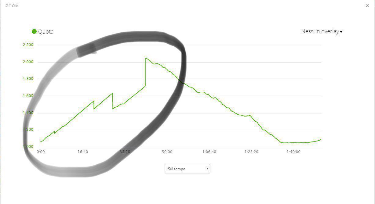

  • Same problem for me with last 5.10 sw. The graph is not linear.ciq.forums.garmin.com/.../1414006.jpg
    Ouch. This is the kind of autocalibration that I have always feared that Garmin would start using: Frequent checks of altitude error, and a sudden recalibration if the error gets too large. That is definitely not the way to do it.
  • The questions is if it was autocalibration or he did it on manual to correct the value od altitude. @antoniovertical could you continous it? For sure it is not working on the way I said becuase at this moment there is no this option. If there was autocalibration on the it must be by DEM, I think.
    Another thing is what id better. If you have this peak but after that real data or od you have nie graph with totally wrong information.
    Also if you chose to do it as manual calibration you also gry the peak od there is a problem with data and you want to calibration it.
    @antoniovertical let us know how you get this graph.
