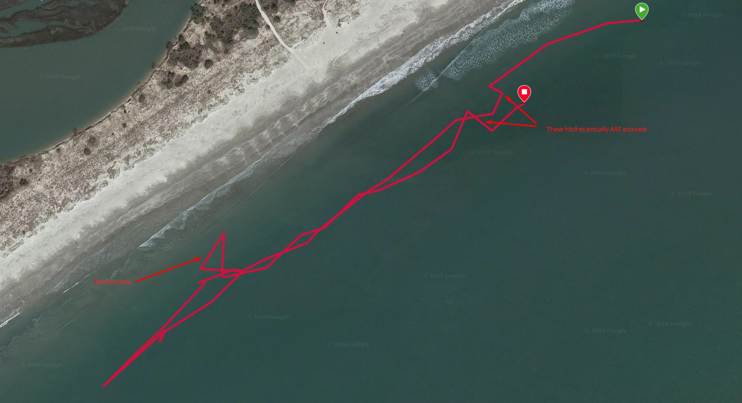

  • Perhaps I'm blessed by low expectations, or perhaps my watch for whatever reason has better GPS reception, but I did my first OWS last weekend and, knock on wood, it was pretty good. I had one inaccurate hitch in my track when I loaded the data in GC, but other than that, it was pretty spot on. Even showing my drift towards shore before I stood up, walked out, and corrected my angle for the waves I was swimming in.
    I was actually pleasantly surprised by the performance. (note this is a Fenix 5 Plus, SW version 6.0.0.0 and I believe GPS 2.3)ciq.forums.garmin.com/.../1466685.jpg
