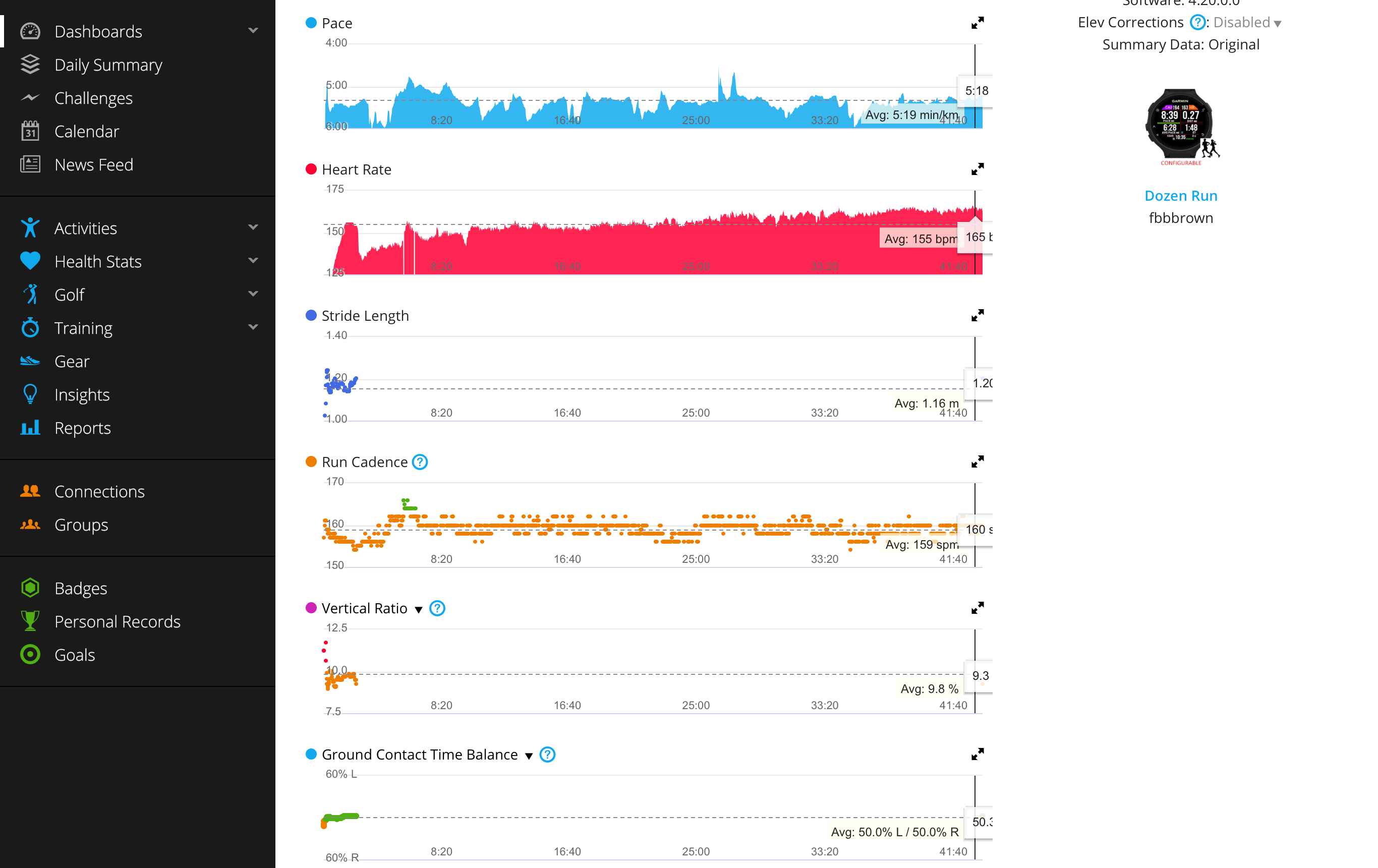

First Gen HRM-Run drops out after 2-ish mins
Former Member
Former Member
Second run with the new 5X+ and it did the same thing on each run - all strap related data; ground contact time & balance, stride length, vert oscillation, etc. stops recording at around 2 mins 14 seconds. My wife's new 5+ (not X) is doing the exact same thing. Still getting heart rate, cadence, etc, but that is likely coming from the watch when it drops the strap out. Battery changed in our HRM Runs a couple weeks ago.
We both just upgraded from 5X's which worked fine with the straps.

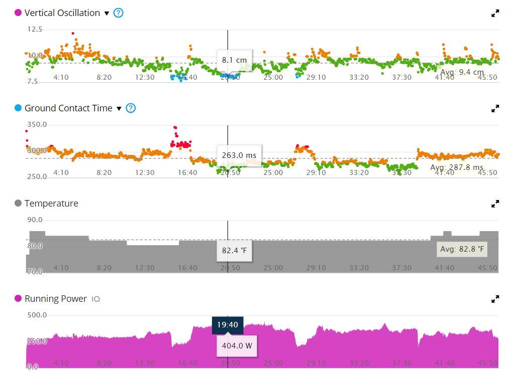

  • Former Member
    0 Former Member over 6 years ago
    Have the same issue with TWO different HRM TRI (old GEN and new GEN) and Fenix 5x Plus. Running Dynamics drop after a couple of minutes... HR is still tracked.
    That look pretty much like a software issue! FYI iPhoneX connected and listened music during run.ciq.forums.garmin.com/.../1392241.jpg
  • you need to CALL support and report it, and state add your user id to the existing case PSC-23192. I was told earlier today by garmin UK support there was a number of related cases that were under different ID's, and they were merging them together to ensure more attention of the topic.
    P.S. i am now getting a warranty repalcement, when the new watch lands (i am off travelling for a few days), ill update here on if it resolves things.. i suspect not as assume its a software issue but if it does... - i have both hrm-run 1st gen, and the red one both have same issue, as does the tri, but garmin uk support stated this was not a user wide issue or it would be much higher up the issues list.... i may do a complete format of the watch later before my next run, as giving it back anyway when i repalce it, maybe a few watches had a bad formatting in the factory...who knows right...
  • It is probably a bug in the ble software that is exposed when something soecispe on the phone side is also present.
    Anyone have this with a galaxy s8/s8+ connected?
  • Former Member
    Tried another run this morning and cut the bluetooth connection before running. It works perfectly! See picture 1. Just to compare a previous run in Picture 2. The strange thing is, that - Garmin webpage does not show the same - see picture in post 103..ciq.forums.garmin.com/.../1392396.jpg
