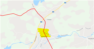

it is huge with 255 data records repeating themselves continuously

the strange fit file savings began in the neighbourhood of Hyltebruk
