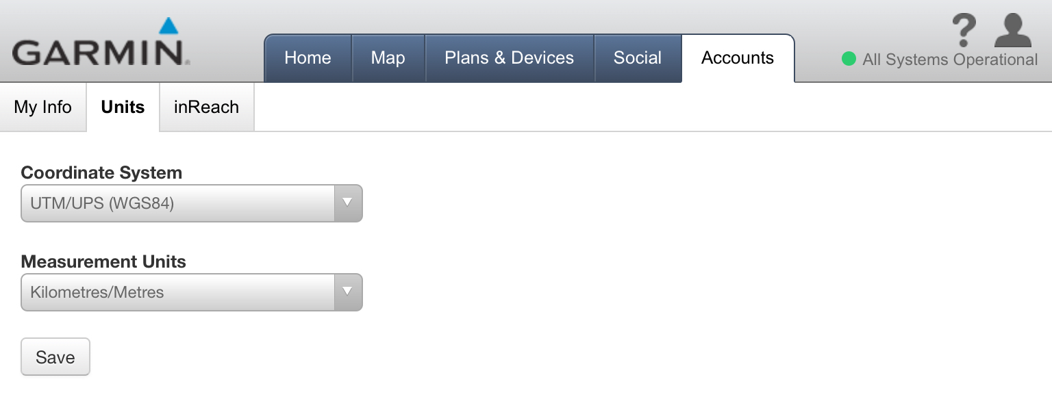

    in the web app https://eur.inreach.garmin.com/Map when i change the units to meters instead of feet. everything is shown in meters, except the contour lines in the map direct. see attached image:
    on the left, it is shown in meters. in directly in the map, the contour lines are in feet.

  • I’ve just had a go at trying to find a setting on the Explore website that switches the contours from feet to metres and I’m equally stuck. The only place you can change units is under the Accounts tab (see pic), but unlike the Explore App that setting doesn’t adjust the contours on the map to metres (it’s always in feet). That is frustrating, but at the moment that just seems to be the way it is.
  • The picture referred to in the post above (wouldn’t let me add it to that post for some reason).ciq.forums.garmin.com/.../1422418.jpg

    Hello Mistamb, currently the contour information on the explore website is baked into the topographic map tiles and they do not change when you change the Measurement Units. This will not change anytime soon but I can look into if there is a possibility to change it at some point in the future.
