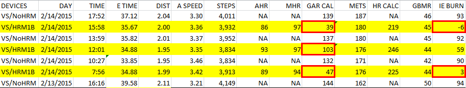

    I have not changed any settings from yesterday to today. No more WAY stupid numbers but some pretty dumb ones with the HRM on nonetheless. Let's dive in:
    The numbers in the red boxes are the REALLY stupid ones. Frankly, all of the Garmin numbers are well below generally accepted norms. A few people have theorized that Garmin forgot to add the BMR back to the HR based burns but that is not enough to explain the difference.
    I think most Garmin customers are coming at this from an athlete's point of view. They have their Edge, their Forerunner, their Swim. They bought the Vivowhatever to account for the other 20? hours of their day. That was my idea and I am far from calling myself an athlete. Unfortunately I am afraid that most Vivo purchasers have no baseline. They bought this instead of a Fitbit because they thought the HRM and Speed Sensor support made a difference for a would be athlete. Turns out ... not so much.
